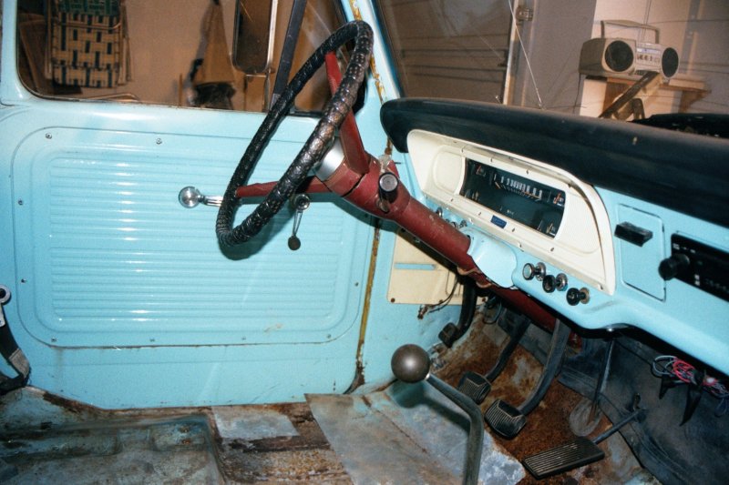

This project has been ongoing from about the spring of 2003. I inherited this pickup from my grandfather and since then my Dad and I have been (slowly) working on the restoration. Since we have been working on it a little more lately I decided to post some of the progress. Here it is when it all started.
