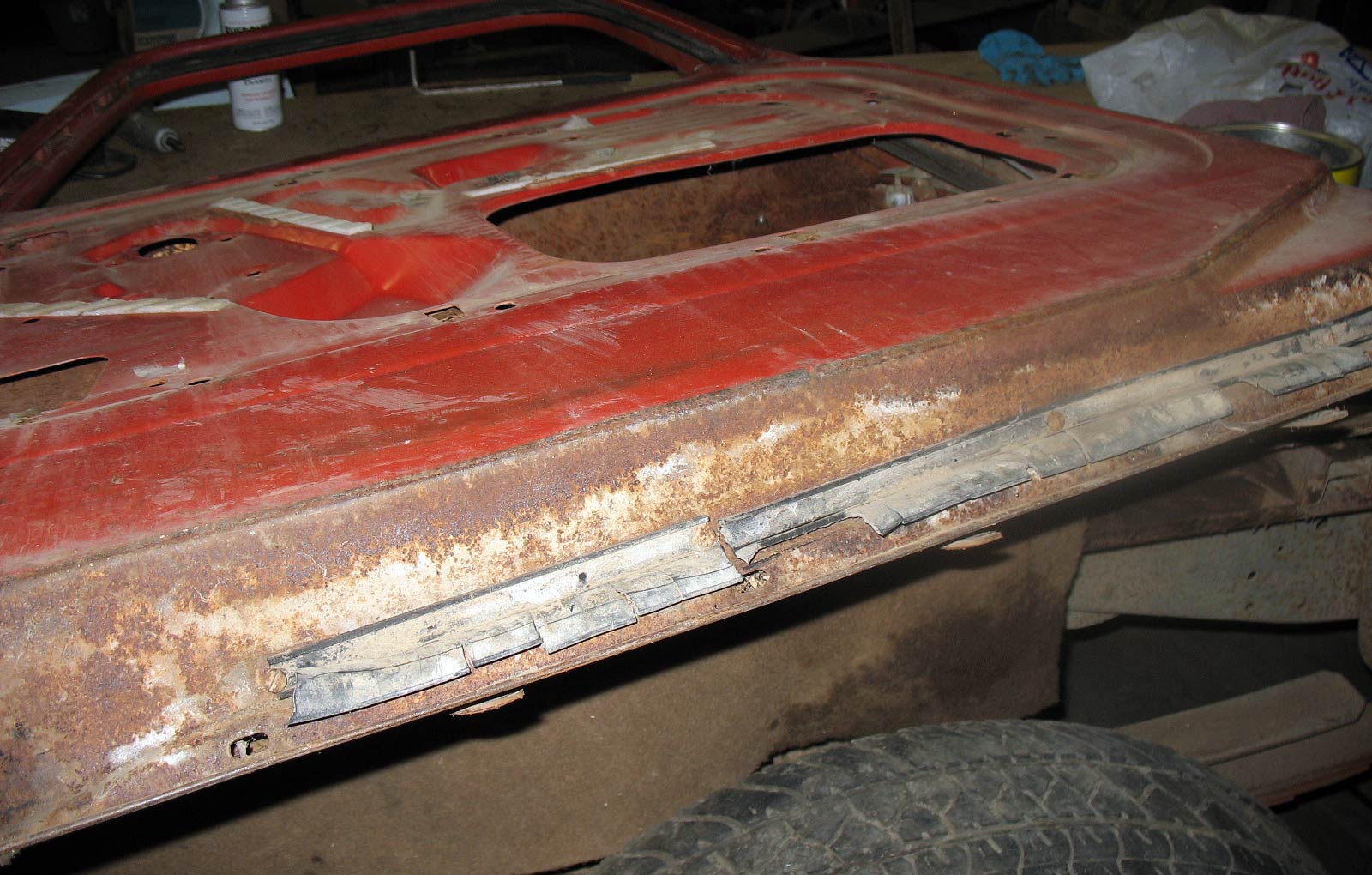

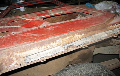

I've parted out lots of bumpsides, and only one of them had some weatherstrip across the bottom. I always thought it was owner-installed. I believe I still have that door in the scrap iron pile, though I think I removed the weatherstrip. I'll try to get some pics where you can at least see the holes for the visual on where it was mounted.

re: On door weatherstrip ?
OK, here's the promised picture....with the weatherstrip still attached. Well, what's left of it, anyway.
Click to enlarge...but it's a LARGE picture.
