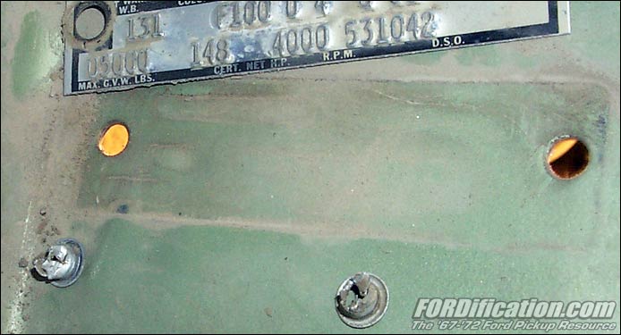

Here's how I removed a set on one of my first parts trucks. Here's a 'before' shot of the VIN tag:

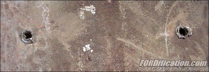

...and here's a shot of the back side of that door area (I stuck the camera inside the door to get this shot). You can see the factory rivets here, and they're pretty rough, so removing them is a breeze. All you have to do is reach inside the door and use a pair of pliers to carefully pinch the edges back together to allow them to be pushed out the holes:
...and here's a shot of the removed tag and rivets. To reinstall, simply insert the rivets back into their holes and then flatten out the backside of each from inside the door.
