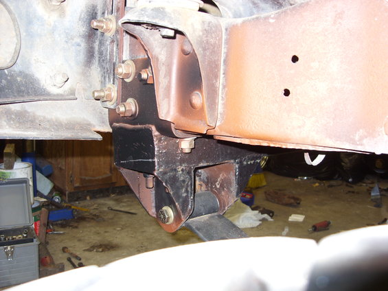

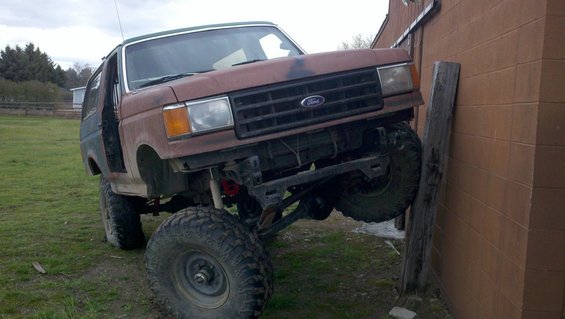

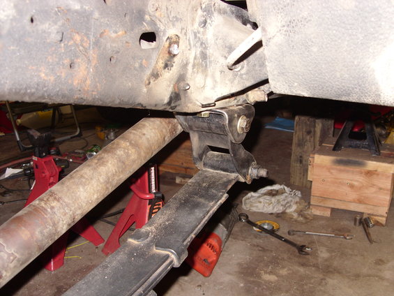

if your sticking with leafs I don't see it being any harder than doing and sas on 80 up rig other than the steering. I would advise going to http://www.fullsizebronco.com and reading every thing is the sas section that has to do with leaf swap and see if your up for the task or not. And I know its not a bump but it was ttb so i didn't have to deal with the tras and transfer case side of things and it did become a bump just on whats left of a bronco frame.
Build a front cosmember
bolt it in simple.
And using the right spring pack get lots of flex and a good ride, and if I had another person to take a picture it could park the front tier up on top and still have the other tier touching.
bolt it in simple.

- Posts: 449
- Joined: Sun Nov 27, 2011 6:24 pm
- Location: Garland, TX
Re: 1969 2wd to 4wd conversion questions
Those pictures make me regret selling my bronco.... What springs did you use?

I daily drove that bronco like that with those leafs up front for almost 3 years and close to 40K in miles. Yes there was a ton of roll but the thing rode like a lincoln, and i'm not the only one to do this and there are quite a few guys who use there trucks and use those leafs. Here is one exaple off the top of my head 7.3 daily driven.averagef250 wrote:Rear pickup leafs up front are real sketchy up front if you drive it. They're great for offroad, but they don't have the stability you need for decent handling.
90's F series rear packs look the same and are the same length as highboy front springs. They also give about 5" lift over stock. The problem is your door will nearly kiss the ground when you try to climb in because the rate is fubar for the front.
Depends on what you want, but research your spring options before you decide. Work out what you want the truck to be good for. I like stiff springs that offer control and let the tires act as part of the suspension (which they are). A fullsize truck that articulates well is pretty useless as a truck, but fun as a toy.
and to quote that guy
Quote:
Originally Posted by Hasley84 View Post
How streetable is the rig? Could it knock down long distance's on the Highway?
I just think it would be nice to be able to have a rig that capable, that you could drive to the trails/desert.
I drove it to koh a few weeks ago. It will cruise on the fwy and doesn't wander that bad at all. It does get body roll if you try to throw it into a corner though.
Quote:
Originally Posted by AllGoNoShow View Post
Do the shocks really make that big of a difference in the trucks performance? In the you tube vid, it looks like the rear is bouncing some, and the front is really eating up the woops/bumps nicely. I guess my question for you is, do the shocks really make up a big difference? Sorry for the dumb questions. I have similar leafs on my truck and have been thinking about doing some high speed stuff.
My rear blows. Its bouncy and it rough as hell. The front stays planted and it smooth through almost anything. If I was to do more I'd want swaybars.
http://www.youtube.com/watch?v=JZB7fxtn ... qSUnTenccQ[/video]
