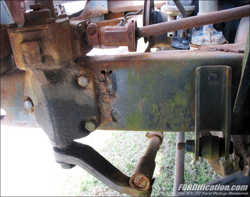

On my 4x4 the steering box is mounted in front of the Dr. side wheel, and there is only a steering slip joint where the steering shaft connects to the box. This picture of Keith's is the basic setup.
