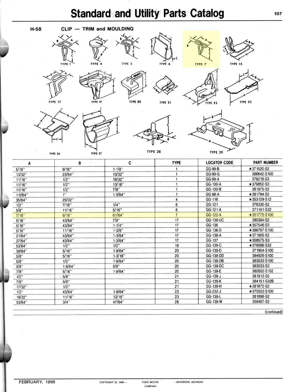

In my 68 ranger, around the glove box, there is a crome trim. I need a couple of clips that hold it on. Does anyone know where i can get some?
Pic of trim is below.

Would you believe you can still get those through your local Ford dealer? That is, if this is the correct one, and I believe it is:
Trim and Moulding Clip
PN: 351775-S 100
Locator Code: GG-122-A
I got this info from a Feb. '96 Ford Standard and Utility Parts Catalog, so it's possible it's no longer valid...but I'll bet it is. Give 'em a call and find out. Here's a scan of the page....click the thumbnail to enlarge:
