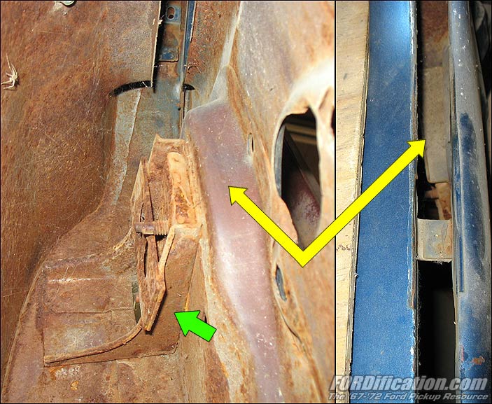

Those preceding three pictures were of the passenger door (simply because they came out the best). Now we move to the driver's door and hinges for the remainder of this. Here's a composite view of the inside of the left door...the left part of this picture is looking up through the bottom after removing the door panel, and the right side of this picture is looking down from the top, through the glass opening:
FIG. 4
You can see how the steel support bracket / cage (labeled with a green arrow) extends too far into the door to allow for a one-piece glass. So...step one would be to make enough room for the glass by removing this cage. Since it's just spotwelded into place, the easiest way by far would be to simply drill out the spot welds.
Keep in mind I haven't actually tried this, but from close scrutiny I believe there would now be barely enough room for the glass to fit in the door and clear the hinge pocket (marked with a yellow arrow). So the next thing to consider would be....how the heck do I now install the hinges??

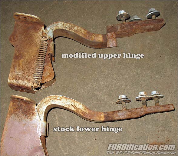

Two ideas come to mind. The first would be to rework the hinge (offsetting the arm) to allow the hinge arm to bolt to the outside of that pocket. Here's a quick Photoshop hack I did of a hinge to show what I have in mind:
FIG. 5
All you'd be doing is offsetting the arm to fit against the outside of the pocket rather than the inside. And of course you'd have to drill new holes and run the bolts in from the inside. Obviously, you'd also have to cut a new slot in the door for the hinge arm to enter, and you'd have to weld the old slot shut.

Now that the door is mounted, you can complete the task. On the right side of Fig. 4 above, you can see how the outer and inner door skins have a thin support brace welded between them for support. Obviously this would have to be cut out. In the kits for Ch*vy trucks there's a chunk of angle iron included to attach along the skin to help reinforce it (I'm not exactly sure where/how it's mounted). Something similar would have to be used here on ours.
FIG. 4
FIG. 5

Kieth your fabricating plans seem pretty straightforward. The first, offsetting the upper hinge to face with the outter side of the hinge pocket was what I was thinking also. (You would offset exactly the thickness of the hinge arm plus the thickness of the pocket sheetmetal, right?) Then you would have to countersink the bolt heads somehow on the inside by the looks of it (for the glass to clear it).

Yes, that's exactly what I was thinking too.jzjames wrote:Kieth your fabricating plans seem pretty straightforward. The first, offsetting the upper hinge to face with the outter side of the hinge pocket was what I was thinking also. (You would offset exactly the thickness of the hinge arm plus the thickness of the pocket sheetmetal, right?)
No, the bolt heads would be right up against the backside sheetmetal of the hinge pocket, so there's nothing to countersink into. You'd have to use some large-diameter washers with the bolts to keep the bolts from pulling through the sheetmetal. I think it would clear the glass OK....but I haven't actually tried it yet.jzjames wrote:Then you would have to countersink the bolt heads somehow on the inside by the looks of it (for the glass to clear it)...

With the bolt heads, the class would clear them maybe. Could you use one of those nice velcro type pads right there ontop of the boltheads to reduce the rattle of the glass against the boltheads? I think there is a one-piece window kit in there somewhere! Hmm.

Could we also maybe just cut out the pockets and tack some nuts to the inside at the original opening and chop the hinge arm down. Then weld on the end a peice that would bolt to that spot?

You mean like I show in Fig. 6 above and described under the pic?rjewkes wrote:...could we also maybe just cut out the pockets and tack some nuts to the inside at the original opening and chop the hinge arm down. Then weld on the end a peice that would bolt to that spot?
