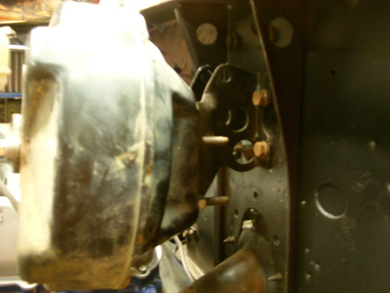

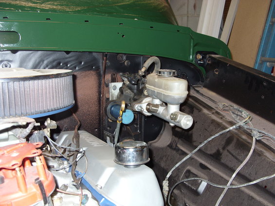

If you run the 89 f350 booster i think i will hit your valve covers on your big block. Here is mine with the half ton booster and it was with in a 1/2" and the f350 one is bigger around and deeper. but all it takes is re drilling your bracket and cutting the rod off your original setup and the rod off the new booster 3/8 die, 3/8 rod coupling and 2, 3/8 nuts. If you can swing the money head down to your wrecking yard and get a hydro boost of an 99-04 super duty same mods to the rod and re drill your bracket and your set also get the non cruse mc. For the full size http://www.supermotors.net/registry/24687/79456
setup out of 88 bronco.
super duty hydro boost

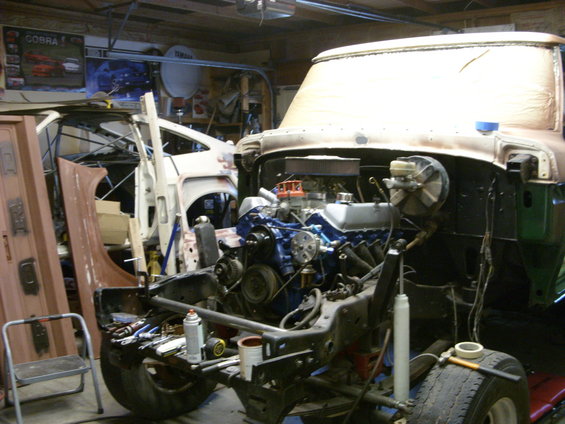

I haven't updated in a while, but here is a mini update.
I bought some airshocks for the rear suspension. Will be a 4 link with 16"x2.5" airshocks, Sway-A-Way to match the front coilovers.
Got the front end sitting on bumpstops and the 42s.
Bought a bunch of tubing, and decided to backhalf the thing. Chop-chop! Cut the frame off right behind where the cab is. Will hopefully start bending up the tube this weekend and getting things welded together.
Dropped the cab in place, so I can bend up the tube to follow the lines of the cab.
Another shot of the cab, showing where the frame is cut.
