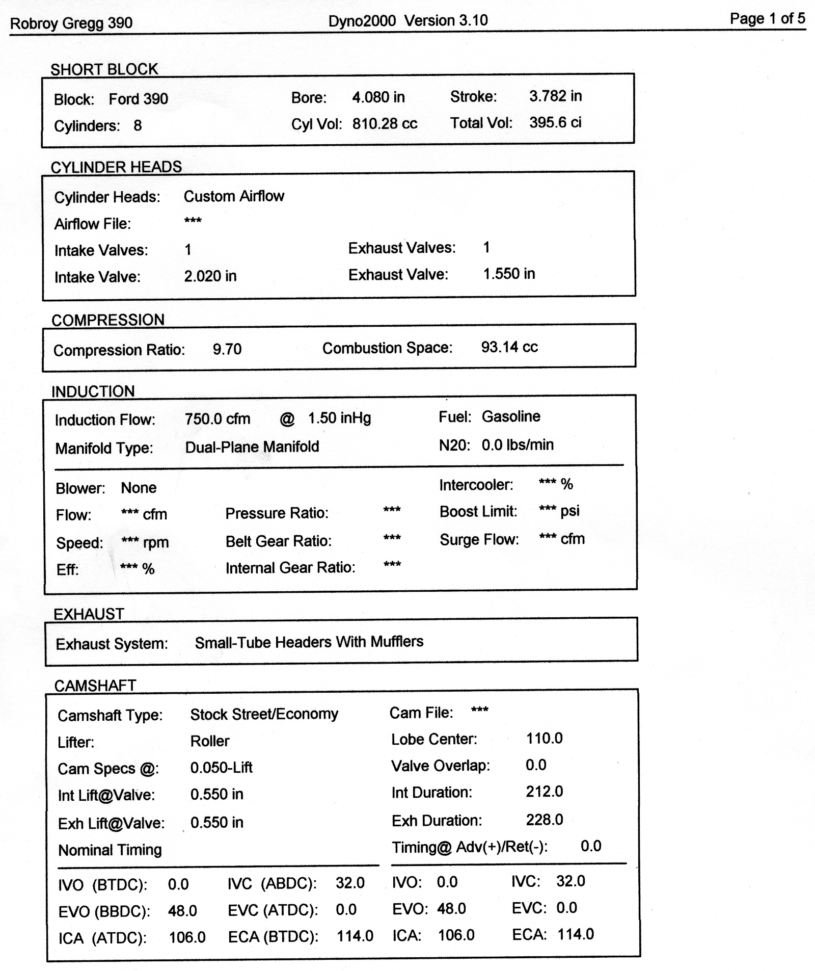

Updated notes on the build:
  1. Using the 428-sized pistons, the engine will have 406 CID.
  2. Tom would like to build the engine with 9.7:1 compression. He likes this ratio because there's a little room for carbon build up before the compression gets so high that detonation becomes a real problem (on high octane pump gas).
  3. I asked Tom about what main upgrade came to mind, if I were going to spend a little more cash than his initial build idea. Tom said the #1 upgrade would be a roller camshaft and lifters! That adds around $700 to the total price, but as I understand it, will prevent the same type of camshaft failure the engine already suffered. I also heard that the engine will produce more torque with this roller camshaft and lifter setup.
  4. Based on Tom's advice, we agreed that I'd go with a Crower roller camshaft (I forget which brand he recommended for the lifters, but naturally they'd be selected to match the camshaft).
  5. With low RPM torque in mind, Tom recommended selecting a Crower grind that will result in a mild "muscle car" type of idle at around 650 RPM. Note that the previous camshaft setup required a 900 RPM idle.
  6. I heard from Tom that unlike their flat tappet camshafts, the Comp Cams roller camshafts are OK. Despite this, since I'd heard good things specifically about the Crower parts Tom said he'd stick to those.
  7. ARP head bolts will be used. The engine already had ARP connecting rod bolts, so those can probably be re-used.
  8. With regard to accessory bolts, I declined Tom's offer to use ARP bolts for those too, since they're more of a cosmetic item there (I'm guessing). Do you think I made the right choice?
  9. I asked Tom about stroker kits. He said that although it would increase the performance potential a lot, it would also add an extra $2,000 on to the price tag for the engine. And considering the type of performance he thinks he'll be able to build in to this engine with the standard 390 crankshaft, I heard that it probably wouldn't be worth it (in my case) for the cost involved. This said, I did hear that beyond the roller camshaft and lifters, the stroker kit would be his next suggested upgrade.

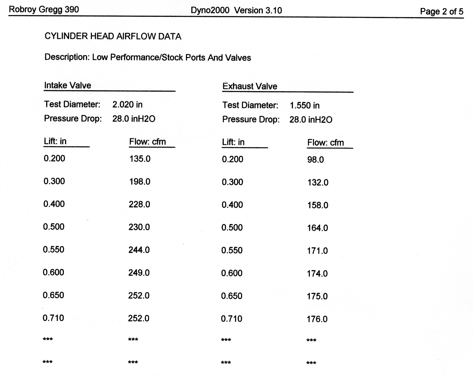

  10. I asked Tom about the Edelbrock aluminum heads. Tom explained that he recommends those heads primarily for high horsepower applications (for light vehicles), because the increased flow through the ports can decrease exhaust temperatures and velocity, which can be torque-robbing. Tom went on to explain that he'll port my existing iron heads, and that removing material from the top side of the ports is more effective for building torque than removing from the bottom side.
  11. Tom mentioned that the new engine should have a 160 degree thermostat, and will like to run between 165 and 170 degrees.

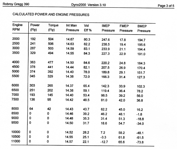

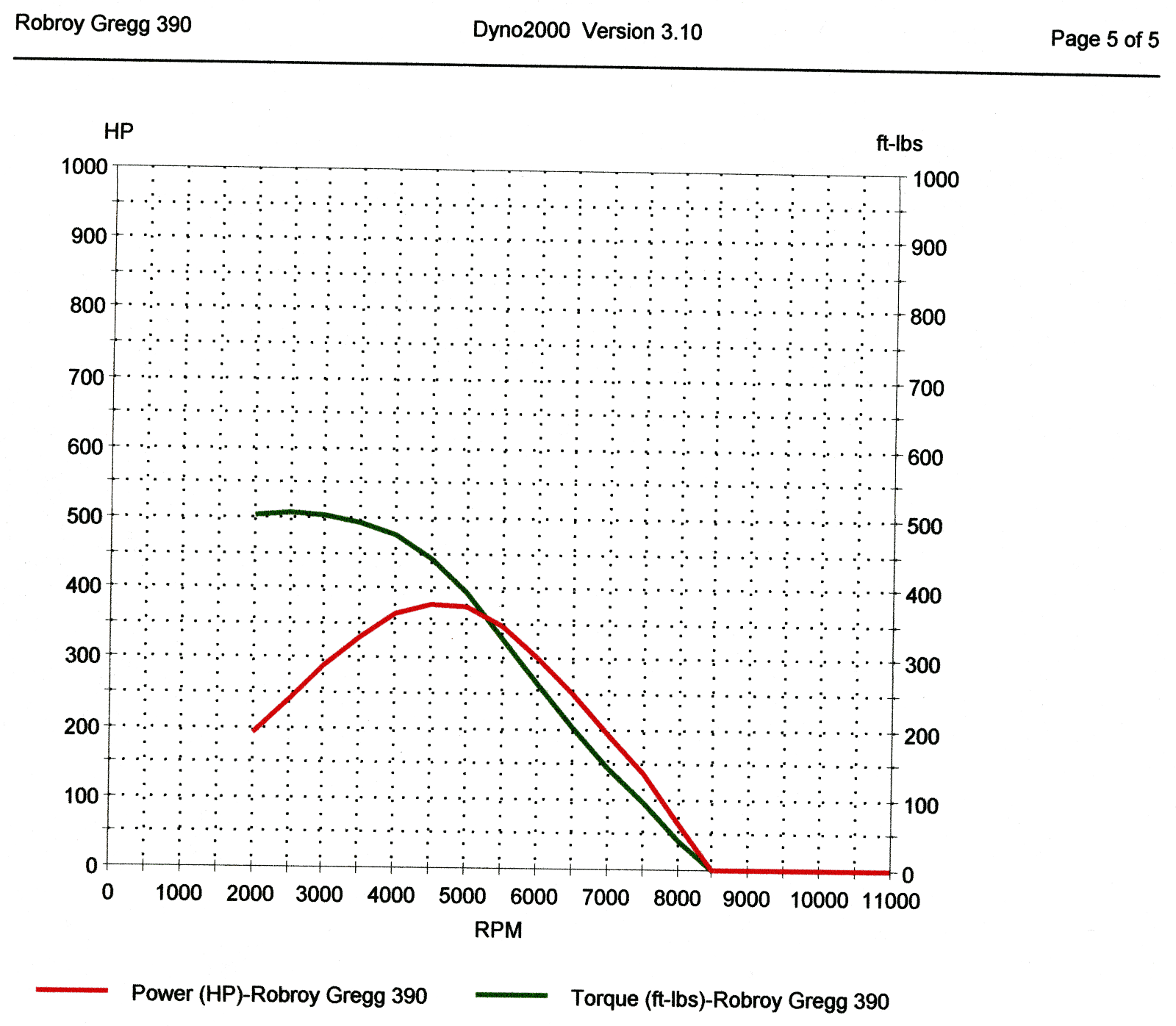

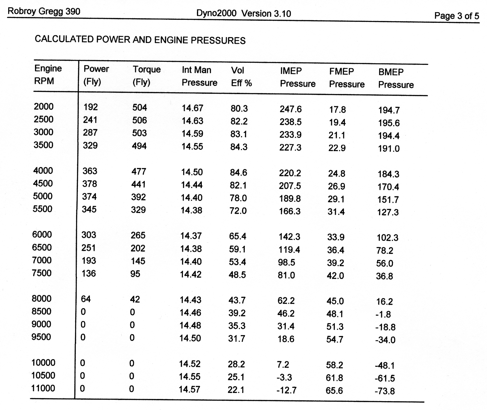

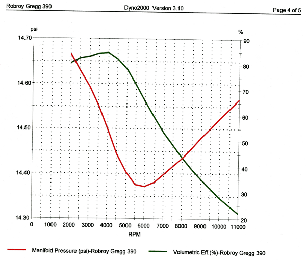

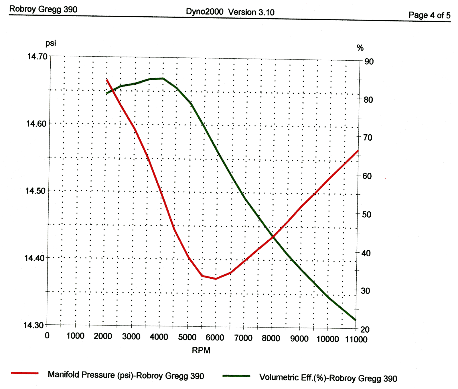

Tom entered some numbers in to his Dyno 2000 software and provided me with these printouts. Although the numbers aren't finalized yet, this shows the performance and temperament ballpark.
Before showing me these numbers, Tom explained that although software dyno numbers can be very misleading, these particular ones should be fairly close. To support this, he showed me the comparison between the Dyno 2000 output for his Mustang engine and the actual dyno output, and they matched within just a few horsepower all through the RPM range! It was really impressive.
I should see if Tom will scan a copy of the draft invoice he wrote for me, so I can post that here too. It's detailed and itemized.
For the moment, I asked Tom to pause activity on the engine until I'd discussed its parts and specs here for a short while. Maybe y'all (there it goes again) will have some advice for me on this!
Thanks very much for the truly excellent help!

500 ft lbs of torque will get ya moving for sure. I'm not even sure my 460 is making that kind of power.

One quick question is it worth redoing the heads you have vs. getting another set from a yard and redoing them?
It sounds like you have a good build coming along, 500ftlbs at 2k is going to move you well, it's almost naturally aspirated diesel territory. Probably a good 2.5" mandrel bent exhaust with a 2" H in the pipes and it should be over 500 at 2500rpm. The compression looks good, should be interesting to see how it runs when done.

iamthewreckingcrew wrote:500 ft lbs of torque will get ya moving for sure. I'm not even sure my 460 is making that kind of power.
Excellent! Yeah that's a very solid amount to generate at such low RPM, isn't it?

Ranchero50 wrote:One quick question is it worth redoing the heads you have vs. getting another set from a yard and redoing them?
This is a great question! Since I have the camshaft and valve lifters already, the heads might be a good thing to hang on to (since they're some of the strongest evidence regarding the type of engine I originally received). I'll ask Tom about this.
Ranchero50 wrote:It sounds like you have a good build coming along, 500ftlbs at 2k is going to move you well, it's almost naturally aspirated diesel territory. Probably a good 2.5" mandrel bent exhaust with a 2" H in the pipes and it should be over 500 at 2500rpm. The compression looks good, should be interesting to see how it runs when done.
Okay, great! So based on what you see so far, what you know about my truck (8,100lb GVW F250, 3.73 D60, T18), would you say this new build is much better suited to my situation?
Am I correct in thinking that this build should perform well across a wide range of RPMs? I remember hearing that the previous build would be "peaky," meaning that it would perform best within a narrow RPM range. And since my T18 is a rather wide ratio transmission, it wasn't well suited for that.

Tom is very good at explaining things, at least it appears so to me. He's very patient and you can see he cares about what he does. The enthusiasm shows through.
robroy wrote: [*] Using the 428-sized pistons, the engine will have 406 CID.
A good number, no replacement for displacement and all of that... :thup:
robroy wrote:[*] Tom would like to build the engine with 9.7:1 compression. He likes this ratio because there's a little room for carbon build up before the compression gets so high that detonation becomes a real problem (on high octane pump gas).
Should be good, depending on the cam and ICA (Intake Closing Angel) will probably take pump premium. I am sure Tom will tailor the static to the cam to get a street-able Dynamic Compression Ratio.

robroy wrote:Tom entered some numbers in to his Dyno 2000 software and provided me with these printouts. Although the numbers aren't finalized yet, this shows the performance and temperament ballpark.
Scans omitted for clarity
It looks to me as if Tom is using very conservative entries which in my experience is the way to go with DD2000 (and later versions, I actually think it got worse with newer versions)

DuckRyder wrote: It looks to me as if Tom is using very conservative entries which in my experience is the way to go with DD2000 (and later versions, I actually think it got worse with newer versions)
I see! Excellent. From what I've heard from Tom, he does tend to make very conservative performance estimates. Even the amazing actual dyno printouts he has all over his wall were done with the engines tuned as they would be for actual driving--he didn't "doctor them up" to get those numbers.
