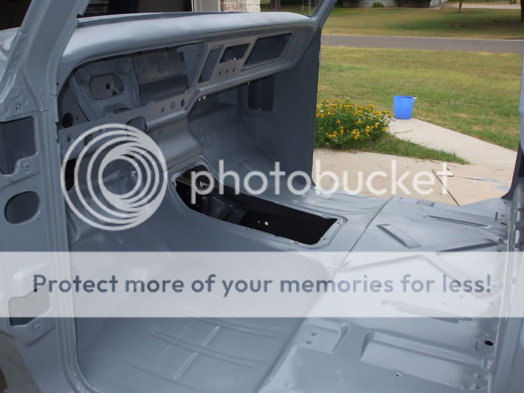

Finally an update, been working a lot on taking off paint and more paint on the cab. today it finally culminated with me getting to paint with some por-15 and primer the entire cab. Sorry I didn't get time to snap pics of the por-15 before I primered over it, but I did it on the entire floor, in the rain gutter, and inside the vents where I could physically reach. Now I can start working on some other things like the doors, front clip and fenders, and bed. Still got a long ways to go.

looking good - did you spray the por-15 on ? - wondered how you got such a smooth finish - it looks freat
Am I right in saying you have to put the primer on whilst the por-15 is still tacky ?
was it any old primer or specially selected ?

I brushed on the por-15 and yes then I sprayed the primer when it was tacky. I am very happy with the results, it smoothed out great. I used a habor frieght HVLP sprayer for the primer. And the primer was a special select oil bast from tractor supply, I belive its made by valspar.
