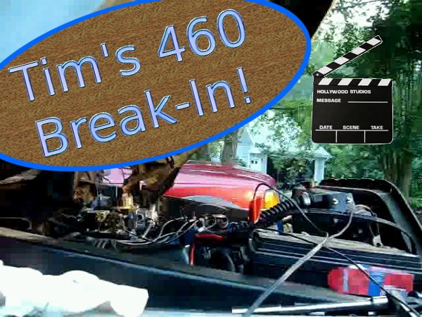

Ok here is the video of the 460 break in. I have to give props to RobRoy for helping me out with resizing the video and a few other things.
I tried to not fill the camera with my back side. But now you end up with my dad walking into view with no shirt on. I cant win.
When I shut the motor down about three minutes into the video it is because I saw something leaking a bit under the truck. I freaked thinking it was oil. It was not, it was transmission fluid. I tried to tighten up a clamp a bit, grabbed a drip pan and continued on. I will just buy new lines from NPD and be done with it before I put it on the road.
