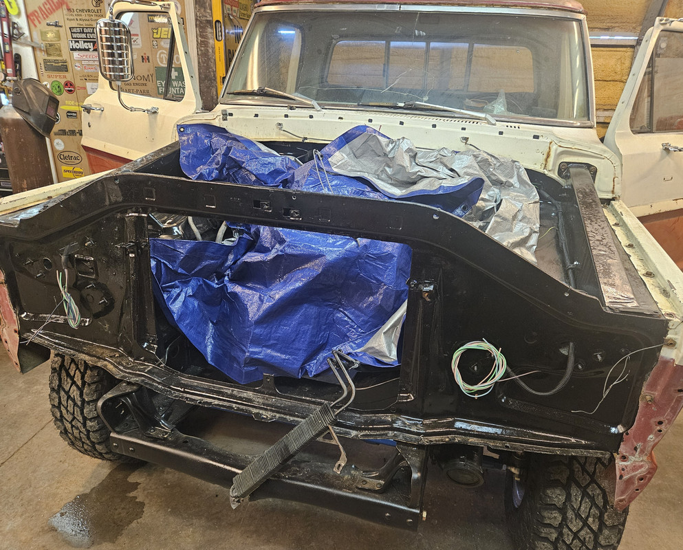

Had some time this afternoon to finally work on Ilene. Engine and Transmission are back in the frame with the Camaro manifolds. I really like the fit of them. The D.S. drops out on the brake proportioning valve, but not hard to move it elsewhere, which was probably going to happen anyway as I'm changing to hydroboost brakes.
Unfortunately, the drive line shop made the O.A.L. of the drive line the C.T.C., so it's way long and will be headed back to get corrected.
Hopefully, I'll get the cab on tomorrow (and maybe the front clip?) so that I can start getting the thing wired and running!

Ilene update (1968 F250 4x4): The cab is on the truck! Made an adapter for the shop crane to lift the cab up and swing it over the chassis. Now that the cab is back and the steering is hooked up, I can move it around much easier. Next up will be exhaust, power steering, and brakes.

Little more work on Ilene this afternoon. Started off by plumbing in the power steering. I wanted it to have ease of part availability, so I used fittings to adapt the 3/8" tube to 3/8" NPT. This allowed me to use an off the shelf 3/8" hydraulic hose. If it ever needs replaced, it's a $15 part.
While the front clip was off, I went ahead and routed the rear chassis harness and installed a set of new sparkplugs and wires on the engine. Hooked up a couple sensors for the dash (water temp and oil pressure) while access was easy.
Then, with the help of the 2nd and 3rd Minions, we put the front clip on. Had to set the hood on and the put the '67 grill in with a couple bolts for the first look. Very happy with the direction this truck is going! As you can tell from the smile, so was the 2nd Minion!
