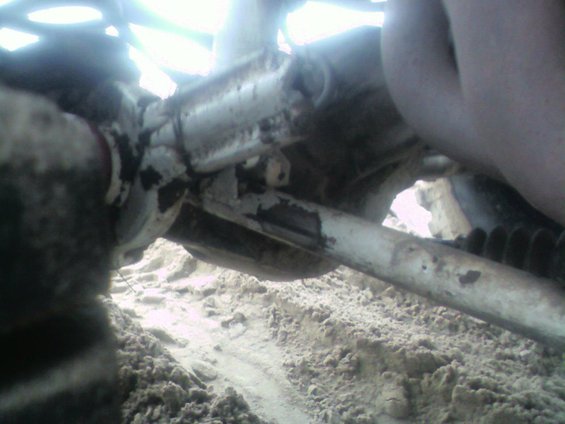

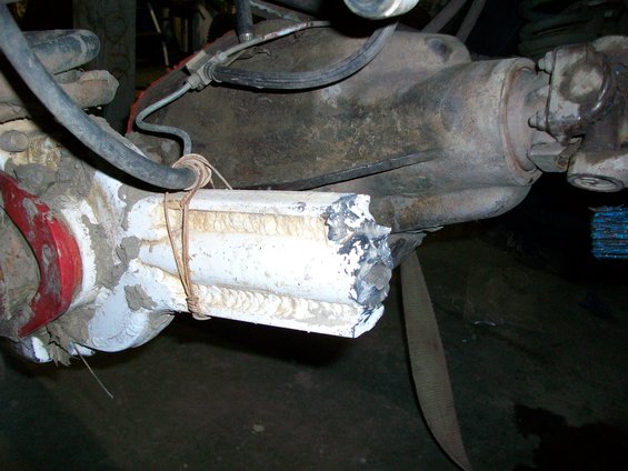

Hey just a peace of advice you might want to plate those radius arms or they will end up looking like this if you wheel much.
Thees where 1 5/8 x 3/8 DOM, ended up platting them with 3/8 plate.

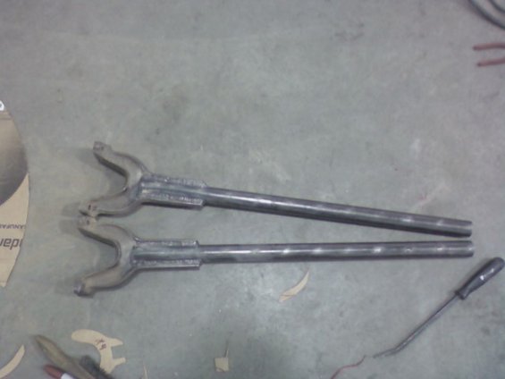

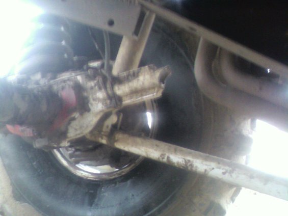

i'm not entirely done with the radius arms yet. i'm just running out of time. start feb 2 i go out of state for work, and wont be doing anymore wrenching or see this truck again until mid-may.

Looking good, And I didn't want to see your truck get ruined if one of those arms broke.

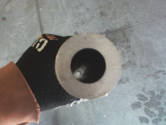

a 2-1/4 x 3/8 piece of DOM is exponentially stronger than 1-5/8 x 3/8. I'm not worried at all. Especially, since this is a mud truck build. LOL
