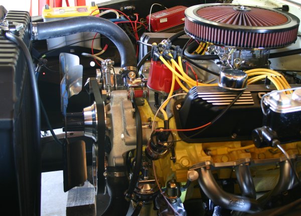

I heard that before taking it on this drive, I should really improve the fan setup. It's still configured with the temporary flex-fan setup with no shroud (shown in this photo), yet Tom's biggest concern was that the fan's much too far away from the radiator to do any good.
In all of #50's test-drives, I never saw the temperature crawl even a hair above 185 (its thermostat rating); the engine seemed completely cold-blooded. It even took quite a while to warm up! Yet I trust Tom's judgment that it ought to be improved before taking such a long trip.
To improve the setup while keeping things simple, Tom recommended putting on a shroud, and using a longer fan spacer to correct the fan's location.
Although I've received a lot of wonderful advice on an electric fan setup, I don't have the time these days to figure it out and put it together. And, the truck seemed so incredibly cold-blooded during the test-drives, that I feel less inclined to get my hands in to such an elaborate cooling system. It's always something that I can tackle if I see any heat issues in the future.
Tom offered to order a shroud for me to LMC, yet the Dennis Carpenter shroud price actually looked better (at $120), and I wanted study the options some. So Tom offered to let me order the parts and have them delivered to his shop, and I agreed.
So I'm currently hoping to find a 6 or 7 blade, non-flex, mechanical water pump fan, and a shroud to match. Tom recommended the 6 or 7 blade fan over the OEM style (4 or 5 blade), and mentioned that he prefers them over flex-fans since they're quieter and more effective.

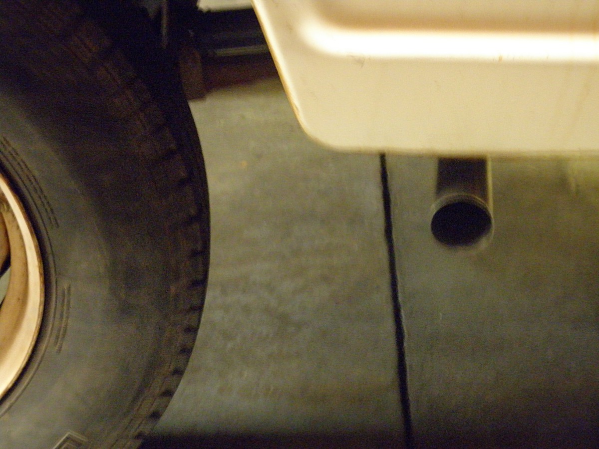

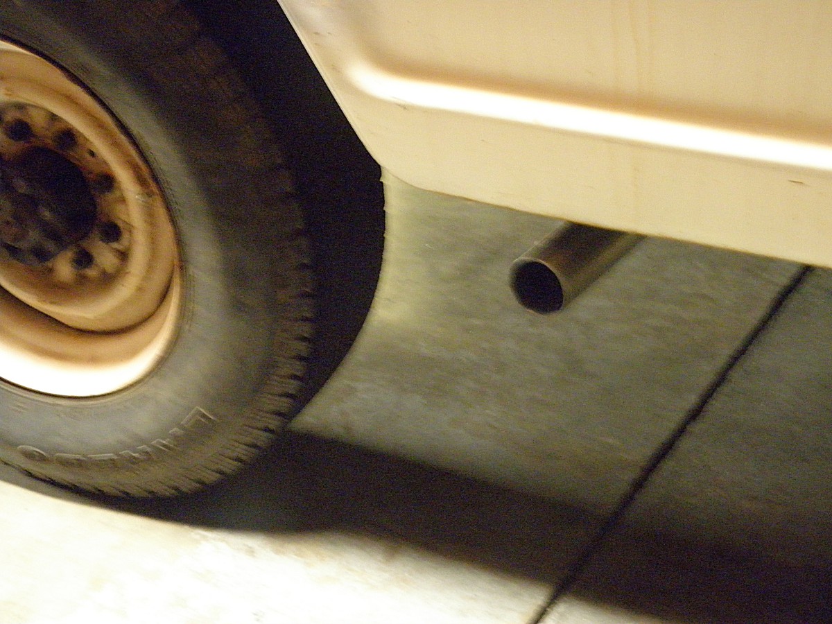

Tom sent me a couple of photos showing the current exhaust pipe exit location, since he wasn't certain that he'd understood what I was asking for. This was the exact location I had in mind though! I sure am curious to hear how #50 sounds now.
EDIT: In case it's not clear in the photos, they show the RH exit, which is right in front of the wheel.
As y'all may be able to see in the right-hand photo, the exit's at a slight aft angle. Tom recommended that instead of going with a perfect right angle to prevent wind from messing with the exhaust flow on the freeway.
