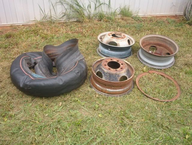

Now to cover the wheels and tires.
I had kept track of my costs as I went through the process of aquiring this truck and doing what few repairs I had been able to afford over the roughly four years I had owned it at this point. The results were rather dismal to say the least. I had a truck that still had a lot of work that needed done to it and had invested about four thousand five hundred dollars in puchasing it and parts to do the repairs that I had done myself. Those little pieces and parts purchases here and there really add up over time.
But I judged it worth it at this point because it hadnt really hit my wallet all at once.
So having managed to arrange a nicely rolling and more importantly....stopping.... vehicle.....I turned my attention to what I thought was the next major problem keeping me from just jumping in it.....firing it up....and driving it with few worries of a breakdown.... the wheels and tires.
I knew this was going to get a little expensive. My initial estimate was more than a little off though.

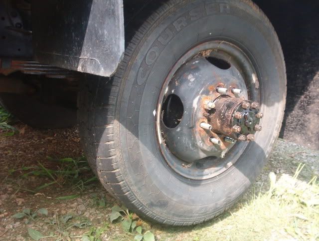

Here's a shot of one of the original wheels and tires that I started with.
What I had discovered in my work so far was that some alterations had been attempted in this area with mixed results by some previous owner.
After some discussion with the guys in the garage at the local CO-OP I decided I knew what needed done. Here is a pic that pretty much shows what was going on.....
What I had was a mix of three different types of wheels on this thing.
I had two of the original split ring style wheels the truck left the factory with mounted to the inner sides of the rear duals.
Three of the proper replacement style beveled type one piece steel wheels. Two mounted to the outside of the rear duals....which allowed for the proper fit of the stainless steel wheel covers that were on it when I bought it. And one on the right front.
The third type was on the left front. It was a one piece steel replacement wheel all right, but had the totally flat non beveled bolt mounting surface that was incorrect for my vehicle.

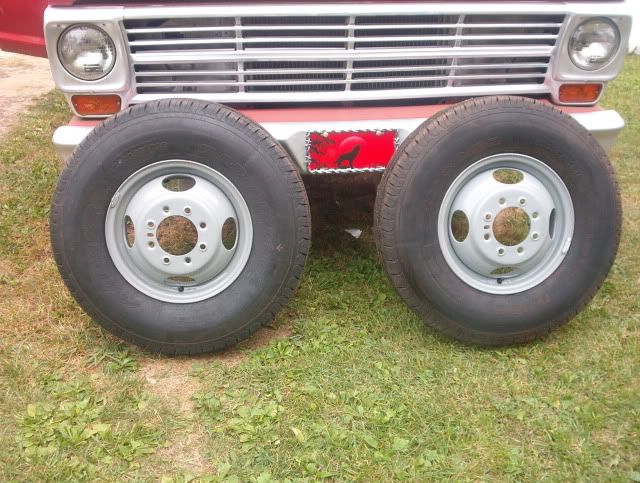

What was needed for the truck was seven correct wheels and seven new tires.
That would give me a good set of tires so I could have a good solid front end inspection and alignment done and one reliable spare.
Heres how I had to go about affording it.
On the left rear of the truck I had two new tires with less than 300 miles on them I had already purchased due to a flat tire. All I needed was two good wheels to mount them on and I could install those on the front. So it was off to CO-OP to purchase two of the three beveled wheels they had in stock. A quick stop by the car wash to wash off what looked like years of accumulated dust and I made a stop at the local TSC looking for a matching gray spray paint to paint the wheels already on the truck to match. No exact match to be found of course....so I bought the next darkest shade I could find. Back to the house with the wheels and paint and it was time to scuff and repaint......two down and five to go. That Saturday I loaded up the two wheels and tires from the truck and the two new painted wheels and headed off to my favorite tire shop.
Here's what I brought home......
What else I brought home was one two piece wheel.... inner tube.... and liner which were of no use to me...and one correct style one piece wheel that needed some serious cleaning and painting.Having used up that weeks paycheck that was available after bills I spent the next week cleaning and painting the wheel I could salvage and waiting on the next payday hoping no one had yet claimed the last wheel gathering dust at CO-OP.
Come payday... I dashed to the bank and snagged the last wheel ...and made the arrangements to order a fourth.I was told it would be at least a week before it arrived but I had plenty to do..... so that weekend I did some work.
I pulled the remaining wheels and tires early Saturday morning and once again headed to the tire shop to have everything broken down......the following week was spent cleaning and painting the 4 useable wheels as I waited on my next paycheck and my monthly kicker check from the military. That payday I went and got the final wheel from CO-OP and dashed home to get it painted and ready for the final trip to the tire store.........I thought.
Come Saturday it was off to the tire shop again and my collection looked like this.........
The only thing that went awry was that the cost of the final wheel from CO-OP was a lot more than the three previous ones.......some thirty dollars. So I saved it for use as a spare and had to wait to get that final spare tire. One more trip to the tire shop... but no real big deal. After that trip I finally got around to adding up costs again...jeez.....no wonder I was broke.
Three new wheels at 100 dollars each...
One new wheel at 130 dollars.....(ouch)....
Two new tires........the ones on it that I hadnt included in costs so far......120 dollars each...
Five new tires at 110 dollars each.......
The paint to make them all match.....65 dollars....
Then I figured in the cost of the alignment.......another 80 dollars......
Thats 1,305.00......sometimes I wonder if it's worth it.........but god I love driving that thing!!!!!!!!!

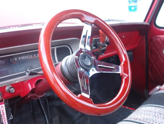

Just to get as much as possible up to date here I thought I would throw in these three pics before I begin the saga of the great overhaul against all the rules.
Heres one of the new steering wheel I chose for it.....by the time I used my rewards card at Auto Zone it was a 60.00 wheel and kit.........gotta love it........

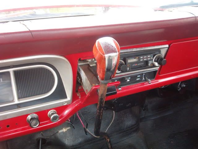

Heres a pic of the shifter knob I chose to go with it.........

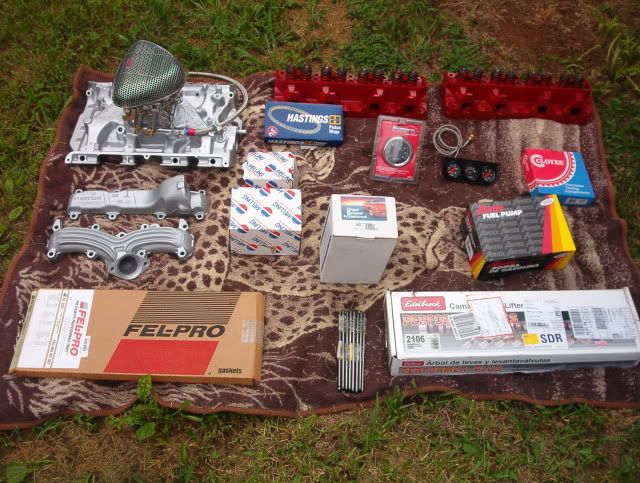

Let me begin this post by saying.......this is my most anticipated and dreaded part of the project to date.
In February of 2009 a very special lady came into my life. And when she did it really became imperitive that Red be running at her best in mid September of this year. The reason being that it is now needed to make a roughly 3,000 mile trip in less than five days from East Tennessee to Missouri..... from there to Kansas....back to Missouri.....and then back home...to fetch her remaining belongings. And that is the only time I will be able to use my aquired vacation days from work.
Needless to say I was under the gun here..........
I did have some warning however and around the first of the year I was able to aquire some parts from a local junkyard. I wont say they were primo by any means. But I was able to aquire a 4BBl cast iron intake manifold......a set of good exhaust manifolds.... and a set of heads from a dent that were part number D2TEAA for 75.00.
That at least gave me a base for the engine overhaul I had in mind.
I spent the next six months aquiring engine parts as I could afford them and having the junkyard parts cleaned .... checked.....and machined and here is what I have to start the overhaul with.........
The heads already have in them the seals from the gasket kit and a set of valve springs that were reccomended for the camshaft and lifters.
And here is a pic of the rod and main bearings I neglected to include in the above pic...
Now I am not going to even try to build some monster engine here.......just refresh an old reliable work horse.........so I would appreciate any comments or suggestions to that end anyone has.
Thanks for sticking with it so far.......tommorrow we tear down.

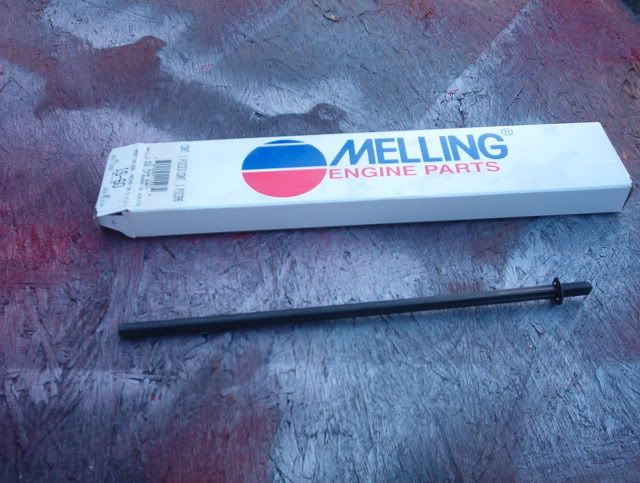

I don't know your skill set, so please don't be offended if the below sound simplistic or insulting....
Make sure it is a standard volume oil pump... it will save you leaks and oil down the road.
Get a new oil pump drive shaft - I like precision pumps billet shaft (~$15).
Use a purolator oil filter. never a Fram.
While the foam air cleaners are nice Bling, get a real paper filter for longetivity.
Get the studs in the exhaust manifold while you are waiting for paint to dry.
Use lots of anti-sieze on the Ex. manifold bolts.
Have the exhaust side of the heads and the exhaust manifolds resurfaced, then when reassembling use no gasket - only Walker Exhaust sealer.
Use a decent torque wrench.
be vey careful putting on the intake... use a cherry picker if necessary to insure it goes on straight and doesn't move the gasket.
A new water pump may be a good idea, along with a new thermostat.
Just a few ideas.
Good luck!
