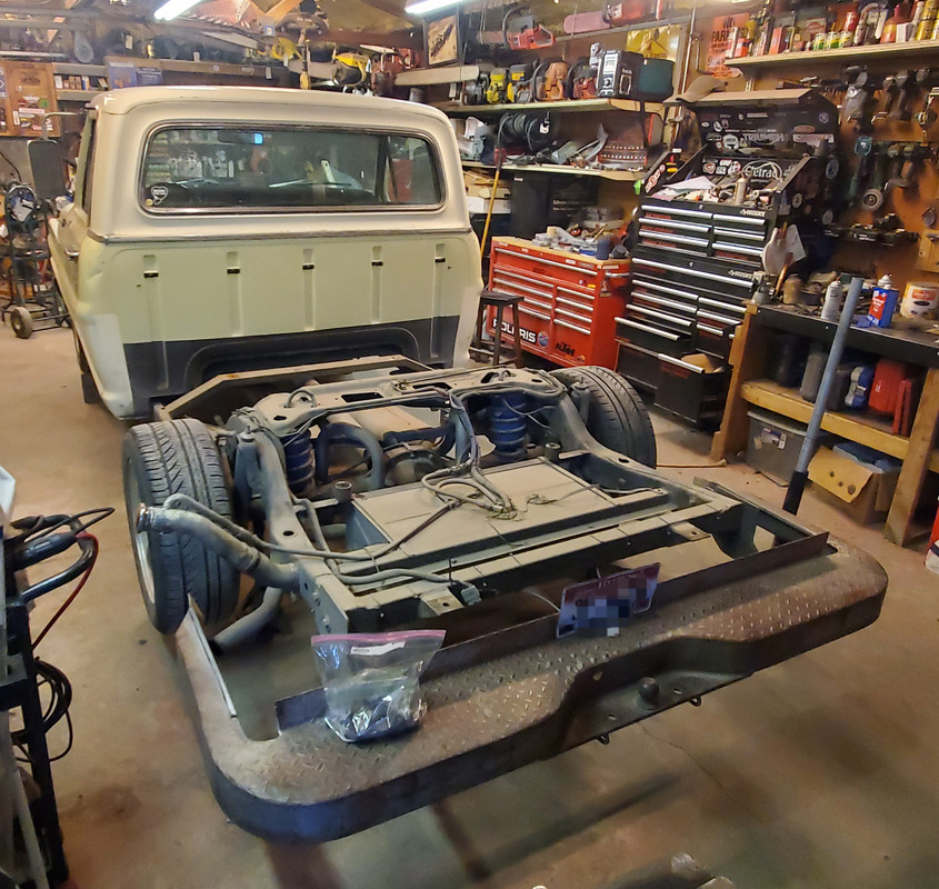

Decided I didn't like the CrownVic radiator fitment, so I ordered a double bypass LS swap radiator... add that to the wait list of parts
Since I'm pretty much stuck waiting on parts, I moved on to working through some of the small stuff. Reinstalled the core support and mounted the power steering cooler.
Then mounted the bumper and plumbed the fuel system
While working on the fuel system, I installed a float less sender in the fuel tank. I've never liked how the lever arm sender worked, hopefully this will be much more accurate.
I was able to reloom the chassis harness and wire in the starter and gauge senders.
Grabbed an extra ECU at the pick-a-part so that I could get mounting mocked up:
Hopefully, by my next day off, I'll have some parts so I can get back to work on getting it done!

This afternoon I had some time to work on the truck, and since the radiator showed up, I rounded up some scrap aluminum and made up a shroud.
I'm using a two speed CrownVic fan, due to the 1800+ CFM on low and 3600+ CFM on high.
Used the shear and brake to make up the shroud, then cut out the hole with my plasma torch and circle jig.
Not sure what coating was on the aluminum, but even after cleaning it up before welding, it did not weld great... but I can clean it up and a coat of paint will hide all that! I'm off work Wednesday, so hopefully I can get the radiator mounted!
My adapter ujoint also arrived, so I was able to install the Ford axle flange on the drive line. I'll drop it off at the drive line shop Wednesday morning.

Had a couple days this week to work on Floyd. Thanks to some aluminum sourced from a good friend, I was able to make a shroud to mount the CrownVic fan to my new radiator.
Since the radiator now had a shroud, today I built a new core support and mounted the radiator and transmission cooler.
The fan shroud works great. It'll suck paper right up to the corners.
It looks like I'll be able to use the Tahoe Air box, which was been a goal to ease maintenance. Pretty happy about that!
I'll work on getting the intake squared away next week, along with the remaining wiring.
