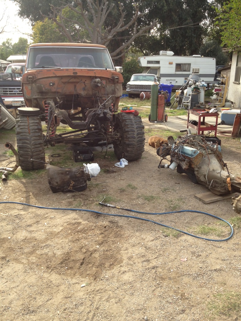

Newest update. I've been chasing my tail all over the place trying to get the Fuel injected motor to run right.. I was trying to solve the high idle issue I've had for years by removing some sensors and replacing them with resistors to fool the computer that it was running right. Of course it didn't work..
And I thought everything on the internet was true.
I was really burnt out and was thinking of throwing in the towel.. It made it even easier to throw in the towel when my buddy's motor in his bronco blew up and he needed a motor. So I agreed to sell him my motor. So I went to my other friends house (Where I did the body swap) to see if he'd help me tear it apart. Well after a long talk and some dealing we came up with a solution. He would pull my motor out and then deliver it to my other friend who wants to buy it.
I'll let the pictures speak for itself.

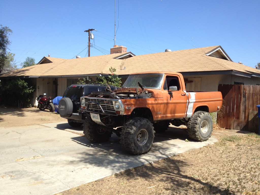

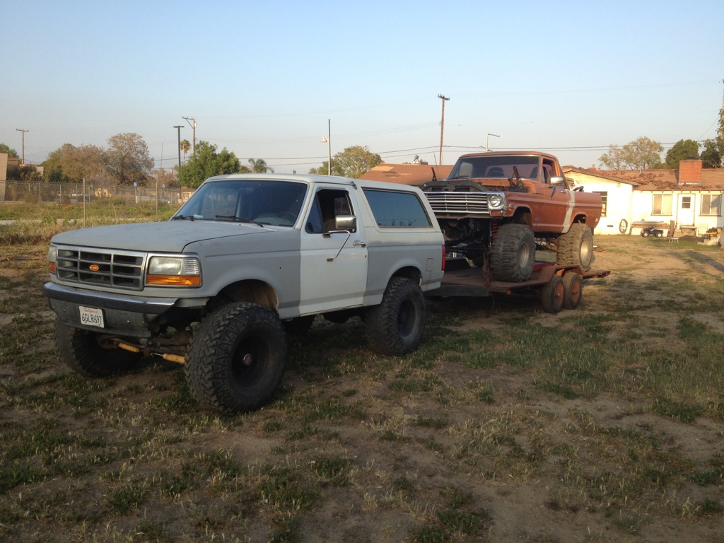

Here's the truck leaving my house

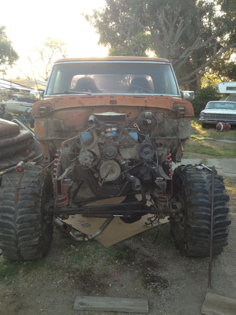

Front clip removed and my engine pulled out.. (That's my trans on the ground) Hmm.. There's another motor and trans on the ground to..

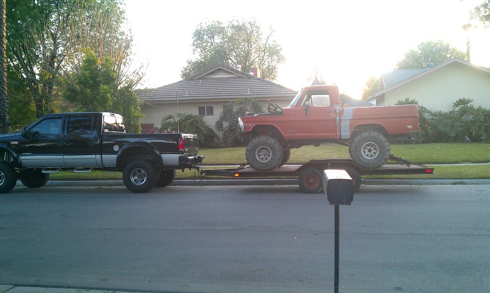

My engine in the back of his truck about to be delivered.
What happened? That looks like the motor that was on the ground.

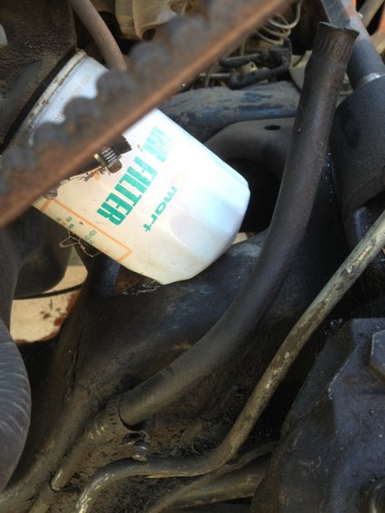

Random pic of the issue with the oil filter fitting.. He notched the cross member a little bit.

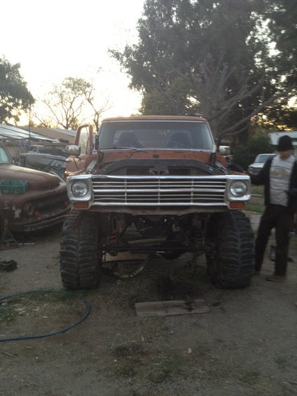

Front clip back on
Overhead shot

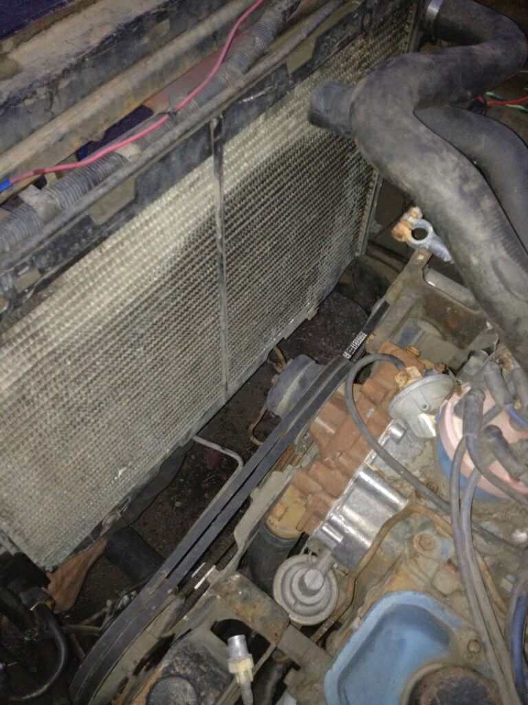

Not much space between the engine and radiator. We thought we couldn't make my fan fit, but he ended up doing it anyways
Front clip back on
Overhead shot

If you want to go with a shorter oil filter a fram ph16 should fit and is shorter . I dont like fram filters but just cross reference it. purolator L14670
- Posts: 139
- Joined: Tue May 18, 2010 12:18 pm
- Location: Riverside, Ca
Re: 69 F250 body on 87 bronco frame
I never had a problem with fram until I took one off of the teams drag racing car and it was sucked in on itself. Then I decided to not run a fram. On my Super Duty I use a motorcraft filter. (If I use anything else it leaks)
I think I'm just going to order a relocation kit and move the filter somewhere else.

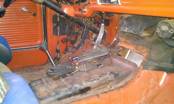

Got bored and decided to temp mount my floor shifter so I didn't have to reach down and shift it from the trans itself.. I still need to hook up the cable but it was getting cold and windy..
Quick shot of a couple of the gauges. Also you can see the B&M shifter adapter for the C6 there.
