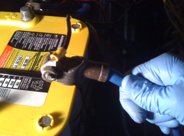

Here's one of my current terminals. The positive and negative wires that power my MSD 6AL are fastened directly to the battery bolts, although they could probably be moved elsewhere.

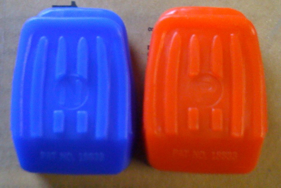

I picked out a NAPA 785122. It's made in Sweden and was $31.32 with tax. Y'all can click on either of these images if you'd like to read the fine print.

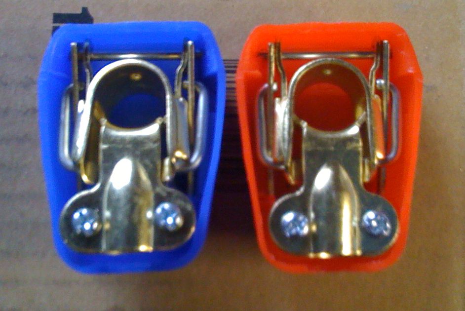

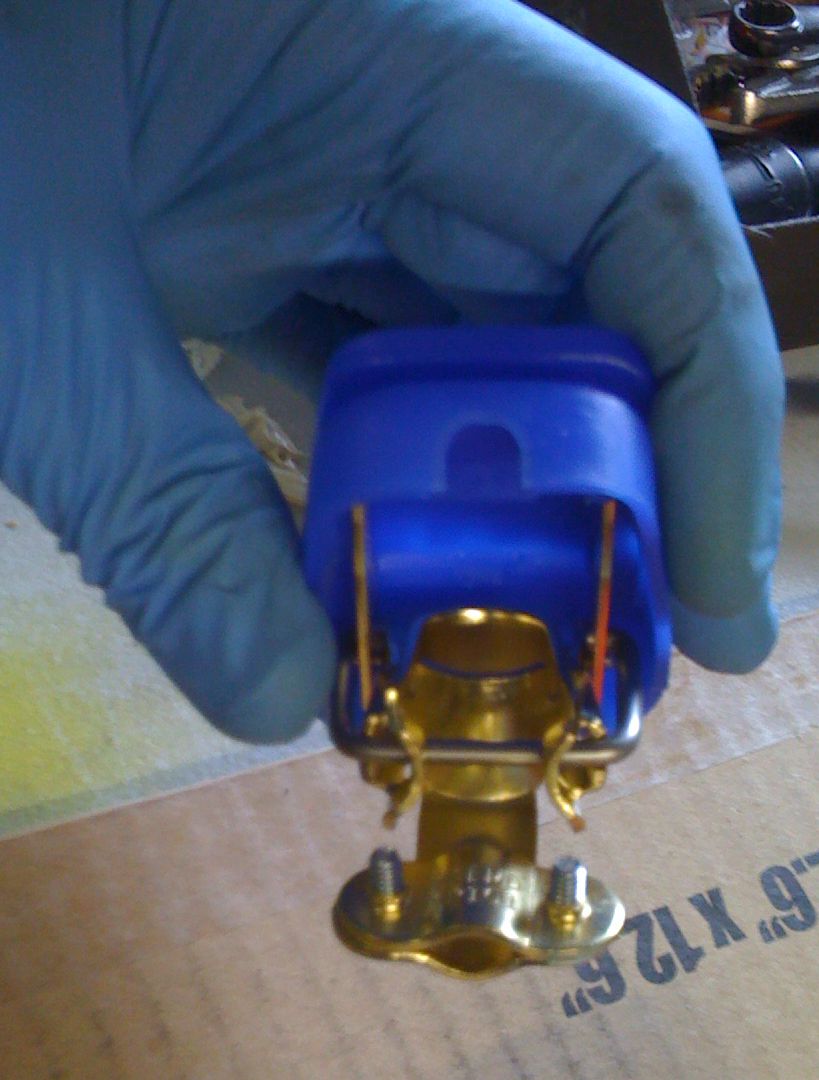

Once I opened the package and looked at these closely, I was impressed by their quality.

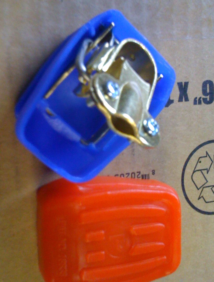

These use a fancy lever design to clamp down on the battery posts. Pulling up on the plastic top un-clamps them and they lift right off!

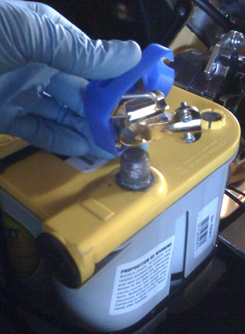

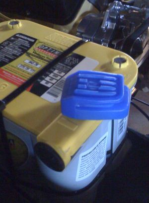

Here's one going on the negative post. Once it's pressed down, it really locks itself in place--it won't budge! And the clamping/un-clamping action feels surprisingly precise and heavy-duty.
