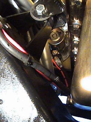

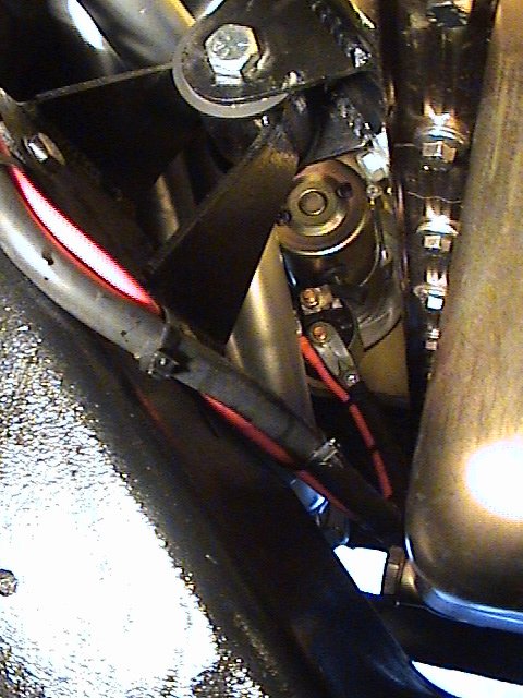

Here's how the wires go from the relay to the starter. I zip-tied them to prevent rampant floppiness.
Here's how close the wires get to the headers. In addition, they're only being held at that angle by the nuts on the starter.
I read from Jamie that I should fasten a loop-style anchor to a nearby bolt to hold the cables in place. I also read about testing the wires by running the starter for thirty seconds, after which none of the wires should feel hot. That was an awesome idea that I haven't tried yet.

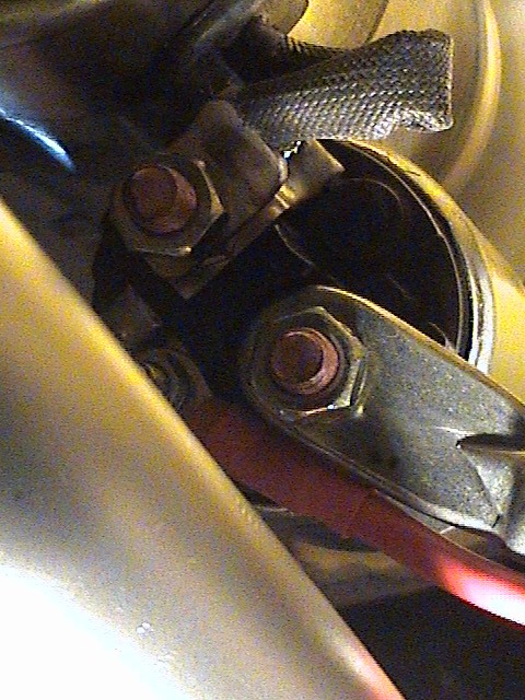

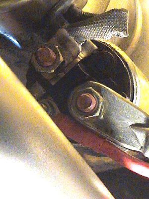

Later I realized that the wire terminals didn't look sufficiently insulated from one another. And since this heat-shield tubing could be conductive, I didn't want to risk getting it too close to the terminals.
Here's how it looks today; you can see that it's quite unprotected.

  2. How should I electrically insulate the wire terminals? Should I install rubber hoods?
  3. Where can high quality, super heat-resistant rubber hoods be found?

The terminals themselves are fine. The only time they have current is during the start mode for a few seconds. If you want a cap anyway, you can. My concern is the heat from the header will melt the insulator caps. The factory did not use an insulator here and how many times have you experienced or heard of this being a problem?
On the heat issue, I see two possibilities, and you may want to both.
1) A heat shield. This could be a 1/8 inch steel plate (sheet metal) cut, bent and shaped to fit the area. It provides a heat barrier mostly. Shape it as a "shoe" to deflect the hot air away from the starter and the wires.
2) Wrap the headers in "Exhaust Tape'. It's about $50 a roll and available at most auto parts stores. You may need 3 or 4 rolls to do all of you headers. This would be each runner from exhaust port to the collector and back further if you think there will be heat issues. If you only want to wrap a 6 inch section near the starter, that's fine. Most of the guys at the track swear they have better performance with a full wrap.

A cap/cover on the Big black wire would be a good idea as that wire has power to it all the time and makes it safer to work around and not short out wrenches to it. :wink: but it is not really a necessary thing just a good safety thing.

Robroy, I would suggest doing a one hole strap to the bottom engine side engine mount bolt and dressing the wires up towards the alternator wiring, possibly bringing everything from the engine to the inner fender in one bunch. When you do use a metal strap (even if it's rubber coated) use some spiral wrap or other abbrasion resistant plastic or rubber.
For the metal terminals on the solenoid I wouldn't worry too much as long as the cable can't bend the big lug over time causing it to short out against the case.
If you keep the wires tucked down by the block and run them up to the alternator harness I doubt you'll ever have heat issues with the wiring and if memory serves, I think your starter guys said they are heat proof.
