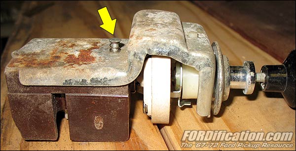

How do you remove these two items without breaking them?

The heater controls are held on with two nuts, accessible from under the dash.
To remove the light switch, push the little button up on top of the switch itself (behind the dash) and pull out on the knob. This will remove the knob and stem. Then just just use a large flat-tip screwdriver to unscrew the bezel retaining nut, remove the bezel, and remove the switch from behind the dash.

Thanks Keith
