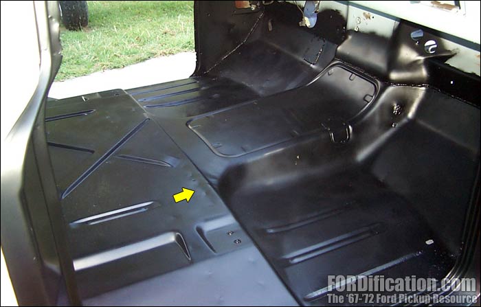

in the rear of the cab just in front of the fuel tank is a small rubber stopper that is hiding the seat bolt hole for bucket seats. there is one on each side of the cab. if you flip your bench seat forward you can see the stopper that is the location of the seat track location for the bucket seats. why they didn't put front holes for the seats i don't know but the rear hole is there.

Fordman, I have a rubber plug, about the size of a quarter that is about 5" away from the bench seat track. Then there is a smaller plastic plug, with a square head, about 12" away. I figure it is the plastic square head plug, right? It even looks like it is the same size as the bench seat bolts.

The cab floors are already marked (dimpled) for the bucket seat brackets, if that's what you're using.

Does the bucket seat inboard bracket have 4 or 2 bolts? If 4, is the plug and dimple for the inside set or outside set of bracket holes?
