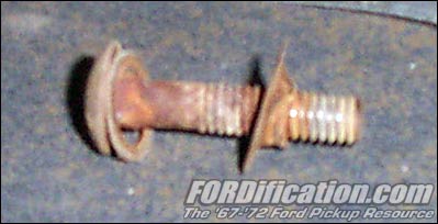

Not all bumpside trucks have this bolt. What is the bolt used for and what trucks used it? (On trucks that DID use it, there were more than one used.)

'67-'69 in-cab fuel tanks are bolted in from the inside. However, the '70-'72 tanks have a bolt going through the rear cab wall from the outside and is held in with the retainer shown, so that the bolt protrudes into the cab...and the tank is attached to this with nuts.
